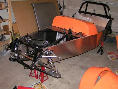

Originally I figured I was doing a budget build so I bought a 1986 Hyundai
Stellar GSL with 1.6L Mitsubishi 4G32 engine and 5spd transmission as my main
donor. I sourced a low mileage Pony axle, Honda motorbike muffler, Minilite
style wheels and a Triumph Spitfire gas tank. I was ready to build the frame.

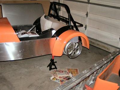

Then I learned that my wife was pregnant again with
our third so I decided to look at pre-made frames due to the new time
constraints. Luego, which is one of the bigger names over in the UK, has a
distributor in Innisfail, Alberta, about an hour and half drive from me. I ended
up buying their demo pile of parts that included frame, fiberglass body panels,
aluminum side panels, steel floor, and suspension bits. It was more money than I
had originally planned to spend on the whole car initially but the quality was
very good. I hauled the frame and other pieces home in the back of my wife’s
minivan, which caused a few curious looks for other drivers. I quickly got it to
“rolling chassis stage” or would have if I had any tires on my rims. Since I
spent all this money on the frame I couldn’t possibly put in an old Hyundai
motor could I? Of course not so one thing lead to another and I decided that I’d
need to upgrade my choice of power plant. Size a real concern in a Seven –
especially height but I think I’ve found my ideal engine that will be revealed
in the next update when the deal goes through for sure.
